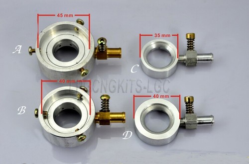

Mixer I could try to make so called "drill-in" into airbox or into carburetor (that acts as throttle only). Also I could try to make a flow-through miver. But there are ready made "plug and play" flow-through mixers on ebay:
mixers
These are for 50-110cc bikes and for 125-150cc bikes with "generic" Keihin-copy PZ 22 and PZ 26 carburetors. There are also bigger mixers available but with very small flow:
as
I have 200cc with PZ30 carburetor, so I decided to play with the mixer on lathe. Just turned some dimensions to fit them with bigger mounting circumference and bigger flow. Also drilled gas channels for bigger section and made some more holes on mixing section. Then polished everything to give a good flow, now it's better than original.
