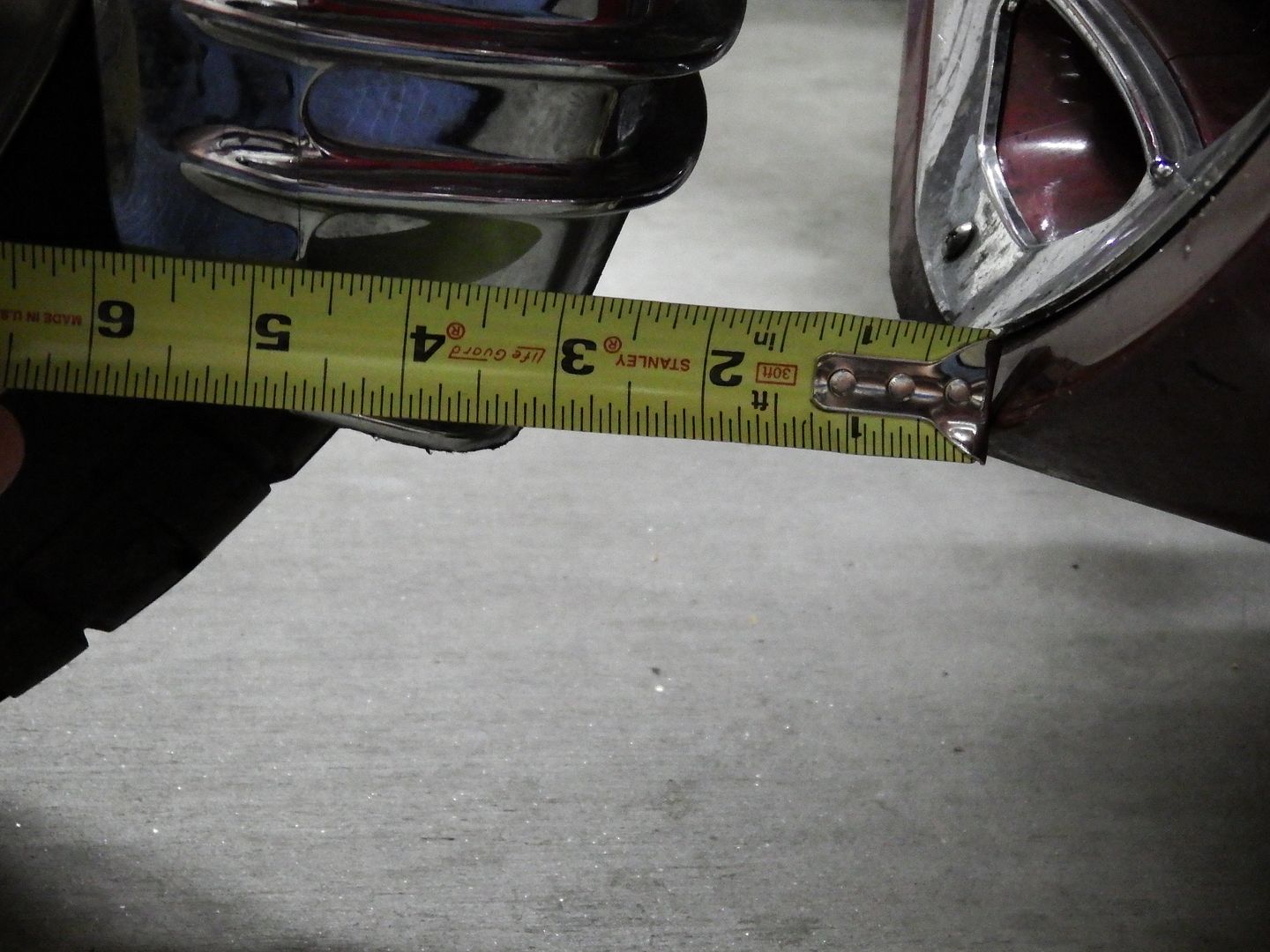

So Fly and CCjon, by looking at this picture with the almost 3" gap between the fender and the Cowl can I assume that I have the Mod? Please disregard the dirt....LOL

Big Tom
I have a 4.5 rake on my 1500 and it is the same measurement as what you have there so I would say your tree's has been changed

Posted 11/2/2016 3:32 PM (#91323 - in reply to #91274)
Subject: Re: How can I tell if my bikes steering has been modified?
Extreme Veteran
Posts: 422
100100100100
Location: DENVER, COLORADO
It is 3" on modified sidecar rig and 1 1/4" on 2 wheeler.
CCjon
Posted 11/2/2016 5:06 PM (#91326 - in reply to #91264)
Extreme Veteran
Posts: 351
1001001002525
Location: NWHouston
Thanks VLAD for finding the answer. That is what makes this site a valuable resource, members helping each other.
