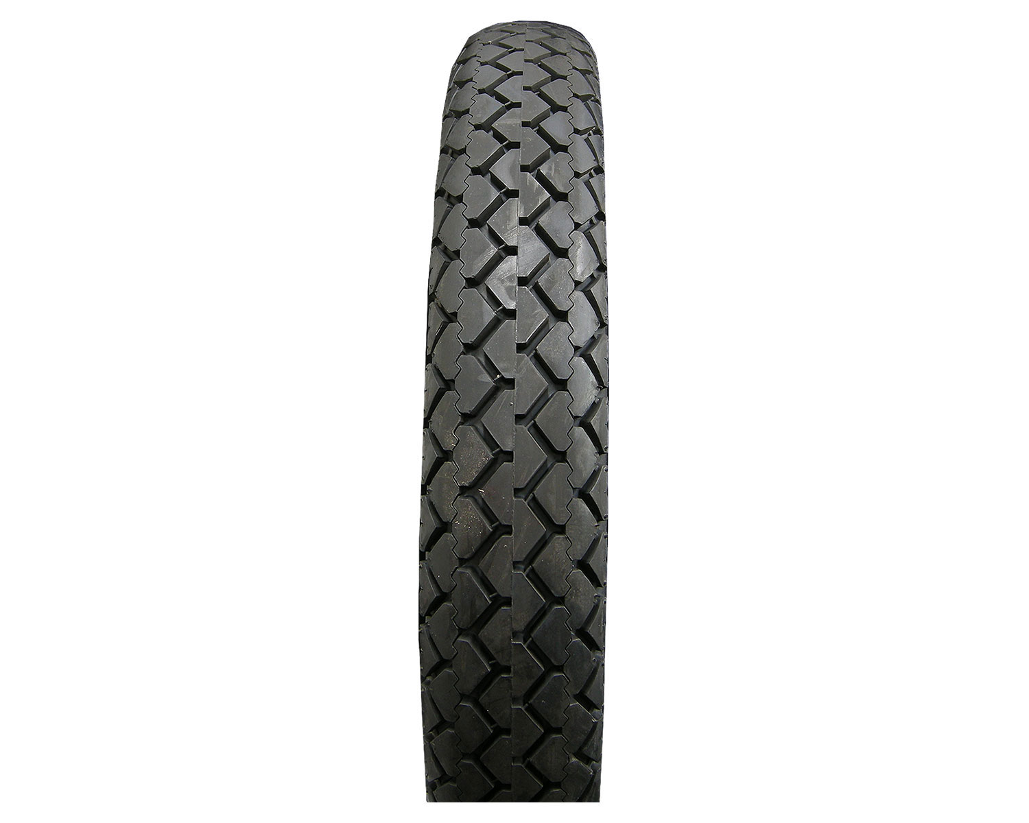

The Heidenau K60 is a round profile moto tire. Also known as the "Scout".
The Heidenau square tire you want is the K28. Pic---->

Has anyone ordered a Metzeler 4.00 X 18 Block K and the tread width is only 3.50?Is this just a typo or are all of them like this?Referring to the pic the tyre on the left is the Metzeler Block K 4.00 X 18 and the other is a Heidenau K28 4.00 X 18.
Thanks

The Block K has been used extensively over the years and been around a long time. It has been mounted with a tube and without even though it is a tube type tire. Cannot recommend mounting it tubeless due to that. From my experience with they they wear well and last a long time is your setup is good. Traction can be iffy if pushed hard but it is predictable with no real suprises once you know the limits. This is not a negative statement just felt it should be mentioned.
