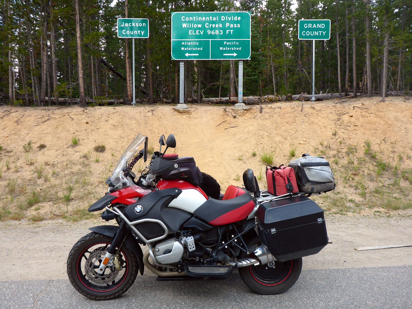

There are no gearing options for the 1200 other than replacing your GS gearbox with the lower-1st-gear "enduro" gearbox from a 2005-07 GS Adventure.  But that's a lot of money and work!
You can get a small improvement by swapping out your 165/80 for a 175/65 assuming you have the normal 4x15 car rim that Claude uses. This would reduce your effective gearing by 6%. This is the size I use. Another nice thing about this is that there is a much wider choice of tires in this size.  Now, it will cause your rear axle height to drop about 3/4". Maybe you can live with this. If not, consider swapping out your front 19" rim for a wider 17" rim from a R1200RT or similar bike. These rims are available on eBay. You can then switch to a 130/70-17 front tire which will drop your front axle height by 7/8" -- which levels out the rig. Again, this is what I've done with my 1200.
On the other hand, if you have Claude's steering mod installed, perhaps your front end is already a little droopy, in which case the 3/4" drop in the rear will be a welcome change.
Here's a side-on pic of my rig and you can see that it rides pretty level fore and aft--
I should point out that though I have a steering mod, I also have the taller Adventure-length shocks and I have made the DeDome modification to my telelever. all of which affects the way the bike sits.
