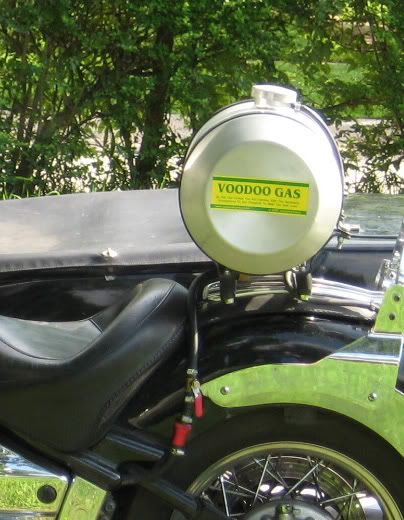

Tour Tank is actually the maker. Their site is listed as Tour Tank. The tanks are all cylindrical to the best of my knowledge.
left profile
4 gallon tour tank
