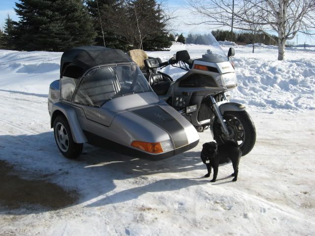

Slowly but surely, the marraige is taking shape
Of course, I'm about ready for a test drive, so we have a major winter event taking place outside.  Oh well, I'll just have to clear the driveway before we go.
