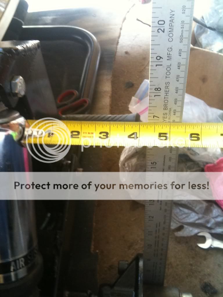

1. The wheel rim needs to be either replaced, or rechromed or otherwise refinished. I'm considering replacement. The rim I have is 13-inch with 4 bolts. While looking up rims on-line, there are a few more numbers to consider. As an example, I see a 13-inch, 4-100 or 4-110 (as well as others). What does the 100 and 110 mean? Is that the measurement of the hub hole in millimeters? Distance between studs? Stud diameter? What is the wheel off-set?
2. Can I mount any 'ol 13-inch tire on the wheel or do I need to match the original as close as I can? Radial or Bias Ply? Does it matter?
3. I don't know anything about the shock, so I'd like to replace it. How does one go about sizing a replacement shock as far as strength? Is an air shock an option?
4. Going to replace the wheel bearings too. No questions here other that if anyone knows of anything unusual about this hub, I'd appreciate it.

If you can find a short air shock, you can give yourself some easy ride adjust.  We used to use a bicycle hand pump on the Hitchhiker.  About three strokes took you from very soft to very hard.

Looks like a standard 4 on 4" trailer hub with 1" axle stub and Timken bearings.
Measure the offset needed from wheel mounting flange to the swingarm pivot point. Do the same with a mounted replacement wheel. A 13" high speed trailer wheel/tire assembly will work just fine.
L.

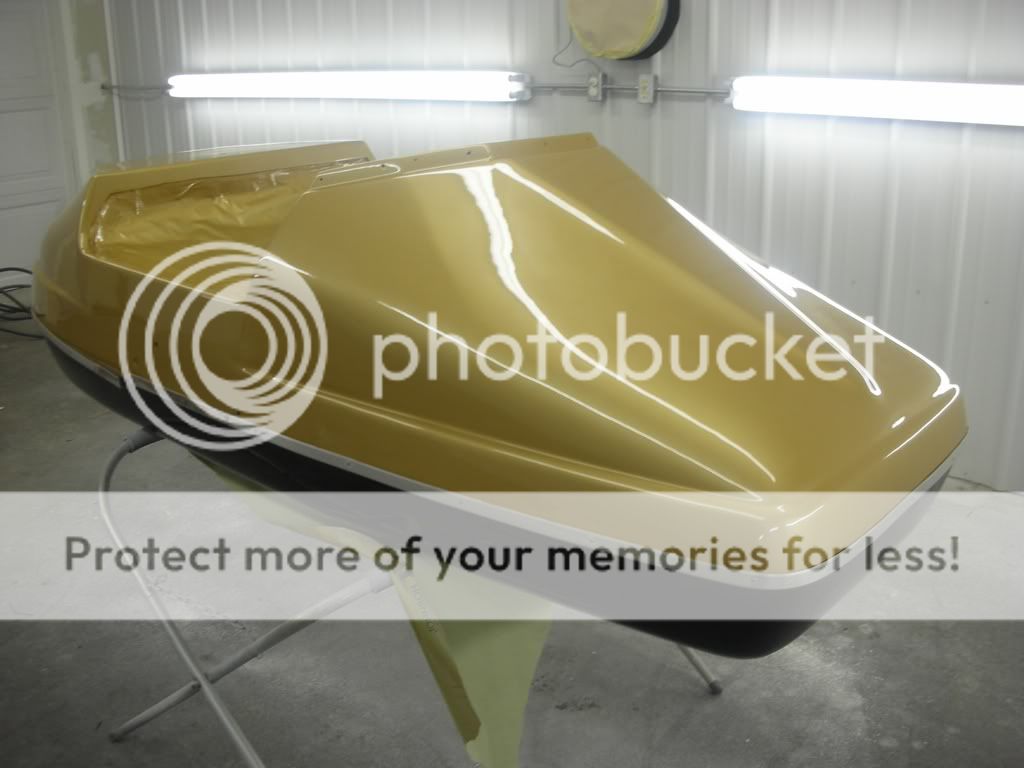

Here is the fender with final color. The painter found a deal on a metalic black, so I went for it!

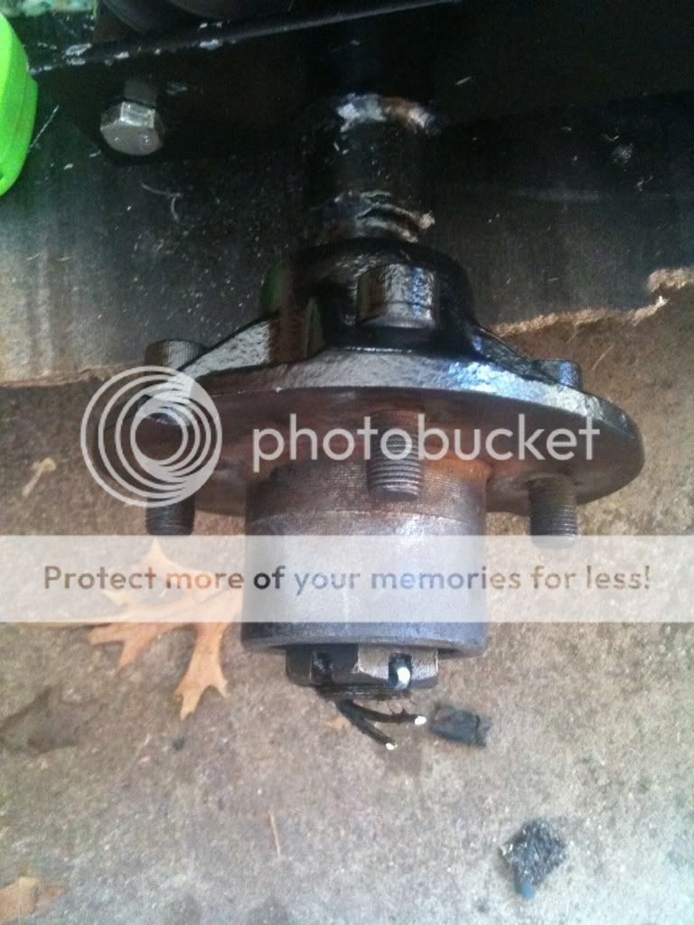

Before I go destroying a perfectly good hub, these bearing faces should be knocked out if I'm replacing the taper roller bearings, correct? The faces seem smooth to the touch and the races roll nicely. But since I'm this far and since a new set is so cheap...

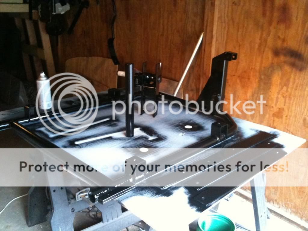

Been a busy week here in the 'ol garage! Finally got the frame all taken apart. Measured up all the fasteners and bought all brand new Grade 8 nuts, bolts and washers where ever possible.
Wire brushed all frame components
Primed 'em
And painted 'em
 But the BIG event is that the painter has finished the tub!!
The Mrs likes!!

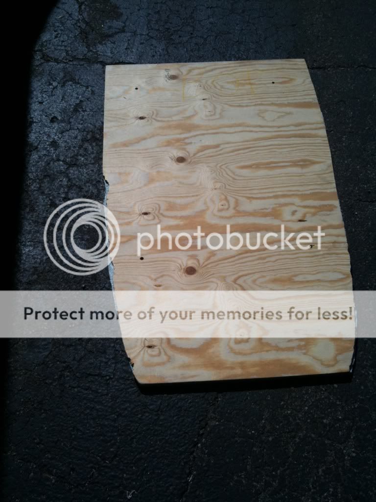

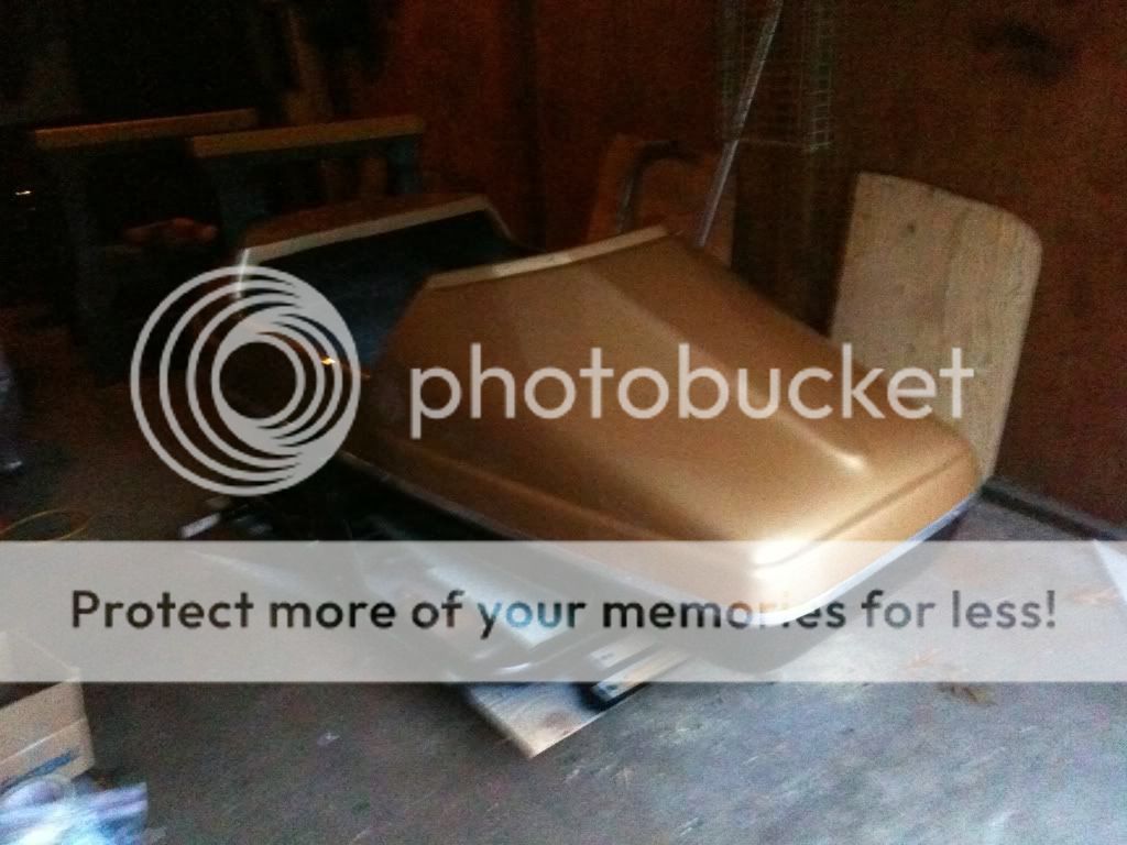

Another busy weekend!
Got the tub home and started preping the frame to receive it.
The new swingarm bearings are a wee bit thicker than the originals.  I drove the new bearings into place and dry fit the swingarm.  I think I may need to shim the pivot shaft to keep the swingarm from binding on the outter race of the bearing.  What do the pro fabricators think about the clearance shown in the third photo?
Next, I cut a piece of plywood to act as a subfloor for the interior.  Glued some carpet pad to it for rider comfort, sound deadening and to bury the bolt heads that connect the tub to the frame
Cut some carpet to fold up into a bowl shape once I shove it into the nose.
 Waiting now on a little help from my neighbor to lower the tub onto the frame so that I can get them bolted together and make the final trimmings to the carpet.  Then I'll start in on the bench seat!

OK, I FINALLY got back to working on the hack! Note to any future (re)builders: If you are working on both a bike and a sidecar, FINISH THE SIDECAR FIRST!! Because if you finish the bike first and the weather is good, you'll find it pretty tough to get back to the hack!! YOU HAVE BEEN WARNED!!
OK, so here is what I got done in the last few days:
Got the tub mounted to the frame. I put it on good an tight, using two nuts. The second nut is a nylon lock nut that I used as a jam nut against the first nut. And if that wasn't enough, I drilled through the bolt tail and cotter pinned it. You may notice that between the bottom of the tub (shiny black) and the frame bracket is a material with a wavy pattern.  That is an iron bar, prolly 3 inches wide by a quarter inch thick.  The bar spans between two frame brackets and spreads the load of the tub and cargo across the mounting brackets.  The wavy pattern is rubberized tool drawer liner I wrapped around the bar (2 layers) to act as a vibration dampener between the frame and the tub..
Next, I mounted the swingarm including the air shock.   At first, I used all grade 8 nuts and bolts.  But when it came time to drill a cotter pin hole, I discovered one of the differences between grade 5 and grade 8.  YOU CAN'T DRILL GRADE 8 with normal backyard mechanic type tools!!  So I pulled it all apart and put it together again, this time with grade 5 hardware, complete with cotter pinning.
 Next, I mounted the hub and checked the tire clearance.  Since the air shock is so much thicker than the original shock, I was concerned about the tire rubbing against it.  Looks like there is 4 inches clearance between the air shock and where the wheel rim will bolt against the face of the hub.  I checked other high spots and found that the head of the axle is the tightest at 3.5 inches.  Since the axle is original, the thickness of the air shock won't interfere with the wheel/tire.  WHEW!
I then dry-fit the fender just to make sure that the air shock and hose will fit in there OK.  I didn't take a picture, but no issues there.  I then wheeled the assembly into the sun to see what it looks like mostly together.  I'm pretty pleased with the results so far!
Next up will to get the rim painted and a new tire mounted.  Then it's time to get the fender on tight, the tail/brake/turn light mounted and wired, the head light and running lights too.  Then I can go for mounting 'er to the Goldwing GL1100 and practice, practice, practice while I work on the interior and cover!  Oh, and get the windshield polished up too.

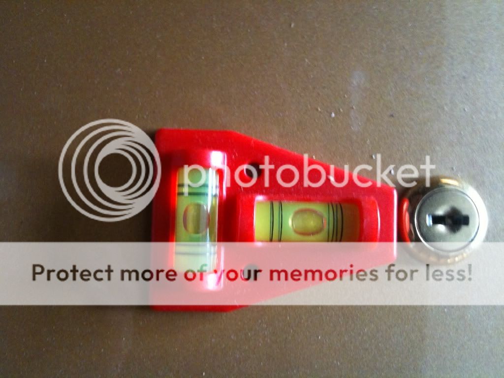

A big day today! I'm officially a "Sidecarist in Training!"  No interior yet, so I'll use my tools to provide ballast while I practice.
I managed to get 'er nice and level too (as seen from the roof of the trunk)

Looking good. I see the key/lock in the pick with the level. Does it appear that someone had put a lock on the previous seatback or what is that for?
Top of the page Bottom of the page
OldSchool_IsCool
Posted 7/11/2011 9:35 AM (#58966 - in reply to #58964)
Subject: Re: Getting a Gemini Ready for the Road (fixed fotos)
Extreme Veteran
Posts: 477
100100100100252525
Location: Michigan - Kalamazoo
SideCar - 7/11/2011 9:15 AM
Yes, that tumbler locks the seatback thus securing the "trunk".
