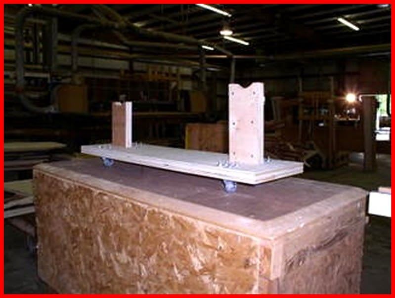

There are a lot of them on ebay all the time.  I have a set of Motorvation dolly wheels, I kept them when I sold mine, thinking I could adapt them to something else.  The best one I've seen started out as a wooden furniture dolly.  Basically a 2x4 frame with a caster on each corner.  With one of these, you can adapt it as you need.  Get a second one for under the sidecar tire and you'll be able to roll the sidecar away from the mounts or back to them by yourself.
