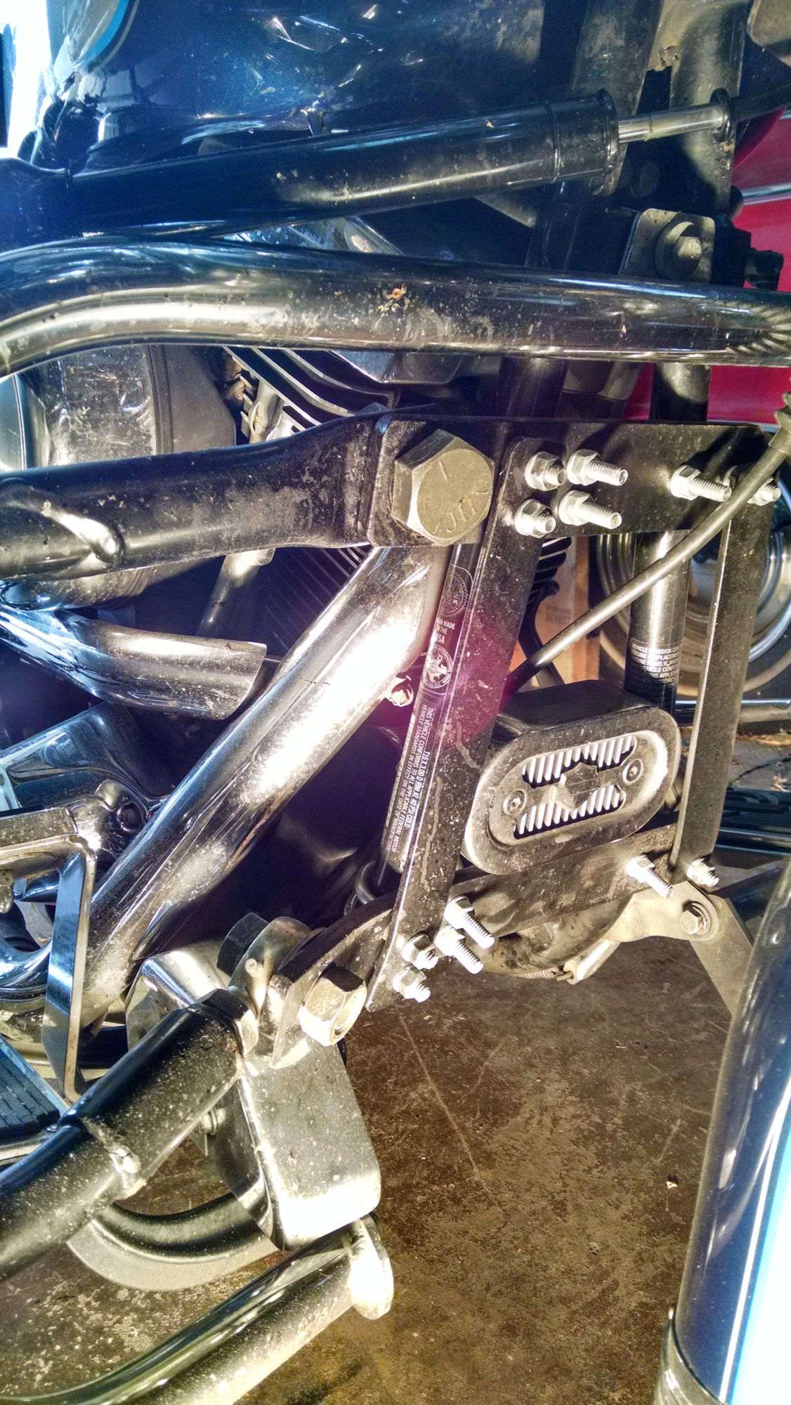

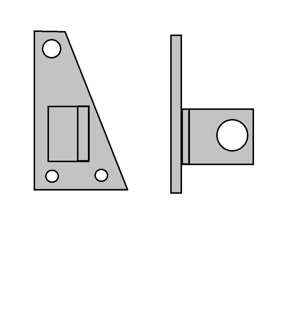

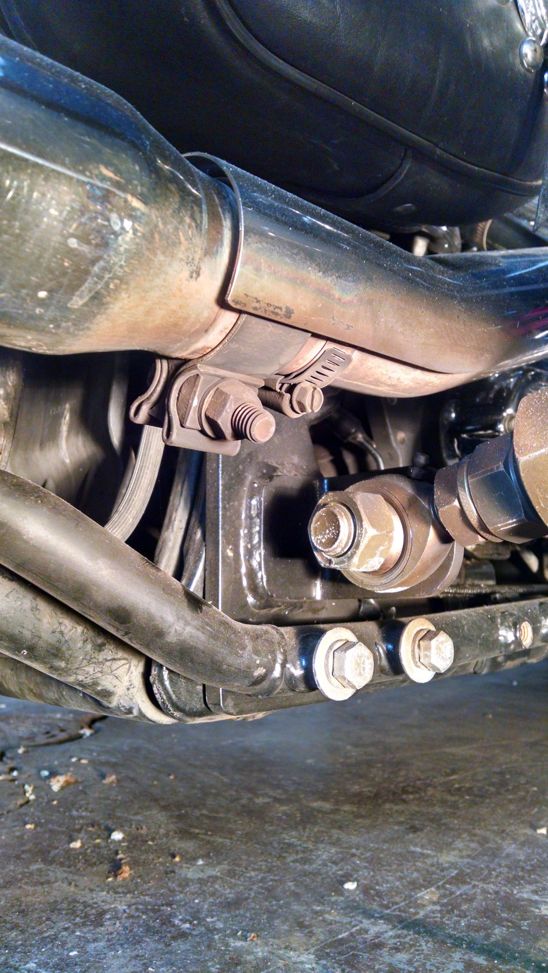

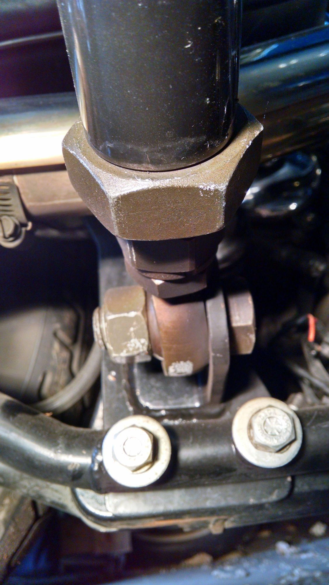

 The hardest part was coming up with a rear mounting point. What I came up with was a 3/8" steel plate that mounts to the passenger footpeg mounting point on top and the two exhaust hanger bolts on the bottom. To this I had a piece welded on to create a mount with a 2" stand-off.

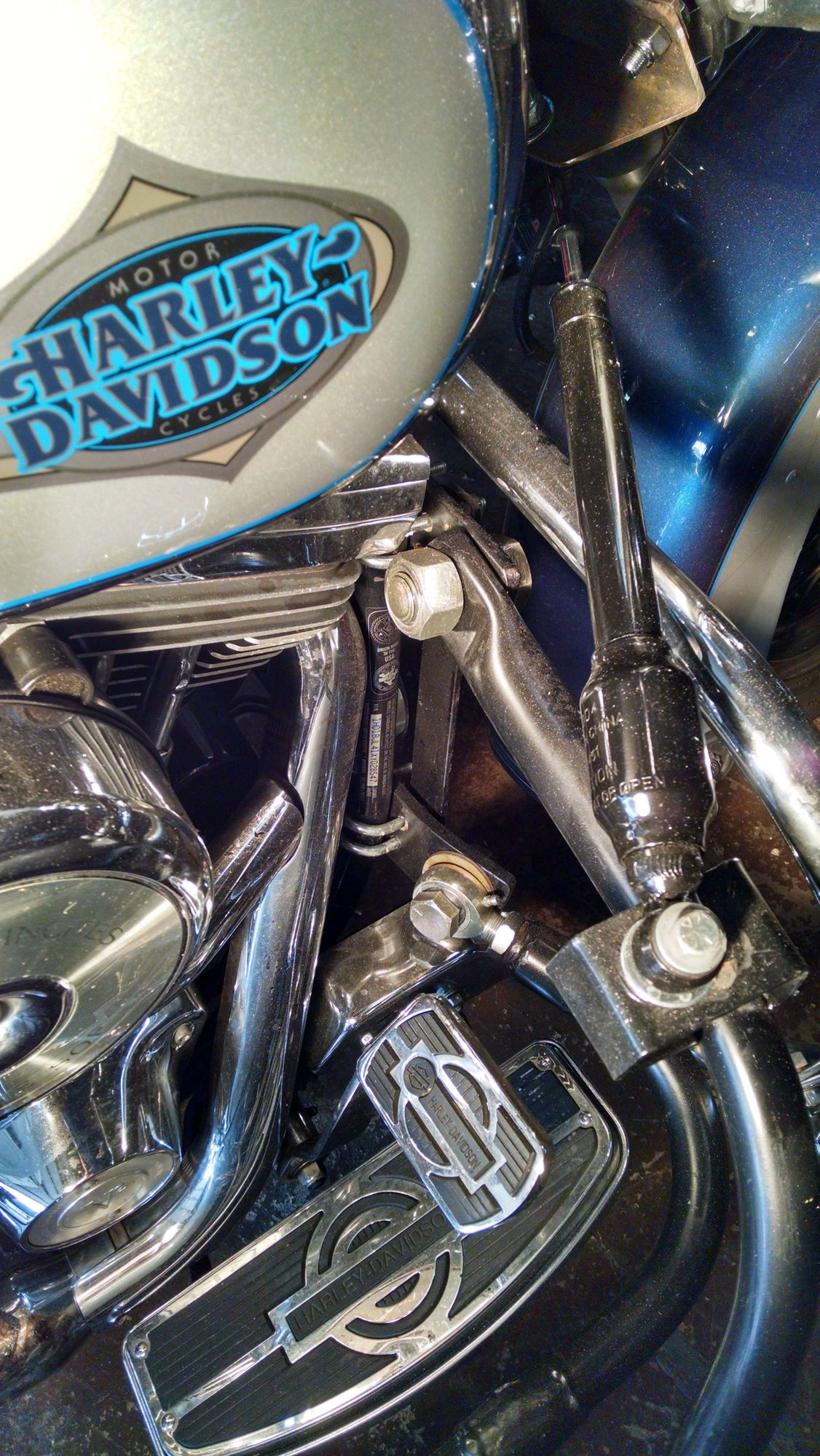

For the front I found this bar at the local farm store
 http://www.farmandfleet.com/products/694902-double-hh-category-1-stabilizer-arm.html
 I cut it into two lengths, did a thousand more measurements and came up with an upper and lower mount that I u-bolted to the frame. Since I don't trust anything I do, I got crazy and doubled up on the U-bolts on each bar. I then got to wondering about the u-bolts shifting up and down the frame during a high stress event and decided to tie them together with a couple of pieces of flat stock.

nice looks stout enough, upper mount to lower mount subframe great stability.

Thanks guys! I went this route for a few reasons. Number one, I'm cheap. Because I had the rear mount made up at work (free) I only have like $40 into the mounts. Number two, I had a lot of people tell me I couldn't or shouldn't do it and I'm stubborn that way. Number three, I'm cheap.
I haven't actually noticed a difference in the rear suspension with this rig, maybe since the car doesn't have a suspension it is less noticeable.
I also added raked trees to my bike, but I'm thinking of taking them back off. They did make it slightly easier to steer but I also got more bump steer now than I like, again lack of suspension on car.
