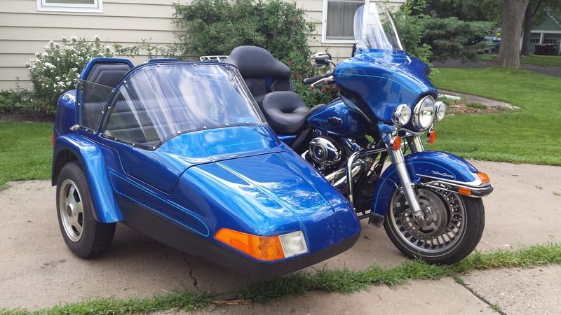

I have an 09 Ultra with a CSC Friendship III. We removed the sidecar from an '86 GL1200. The Ultra makes for a good tug. Steering is a little heavier then it was on the wing...but not insurmountable, but I am 32 and have pretty good upper body strength. You may wish to look into raked triple trees after trying the rig out.
It was my belief that the friendship III came in 2 different frame sizes. The shorter frame fit the GL1200 and Harley bikes....and the longer frame worked on the GL1500/1800 bikes? Either way, I am sure Jay will help you get it worked out, and you will love your new sidecar!!
