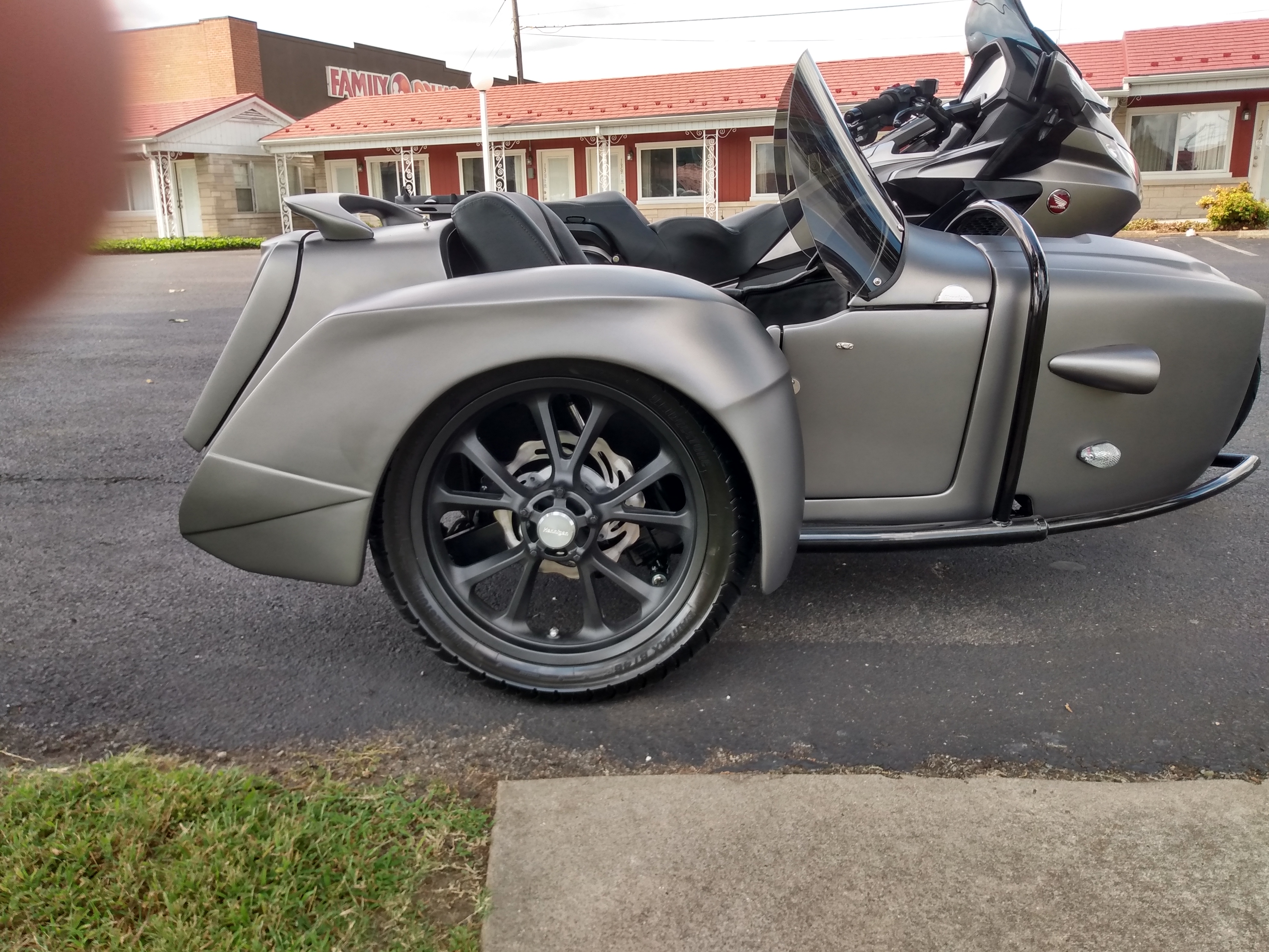

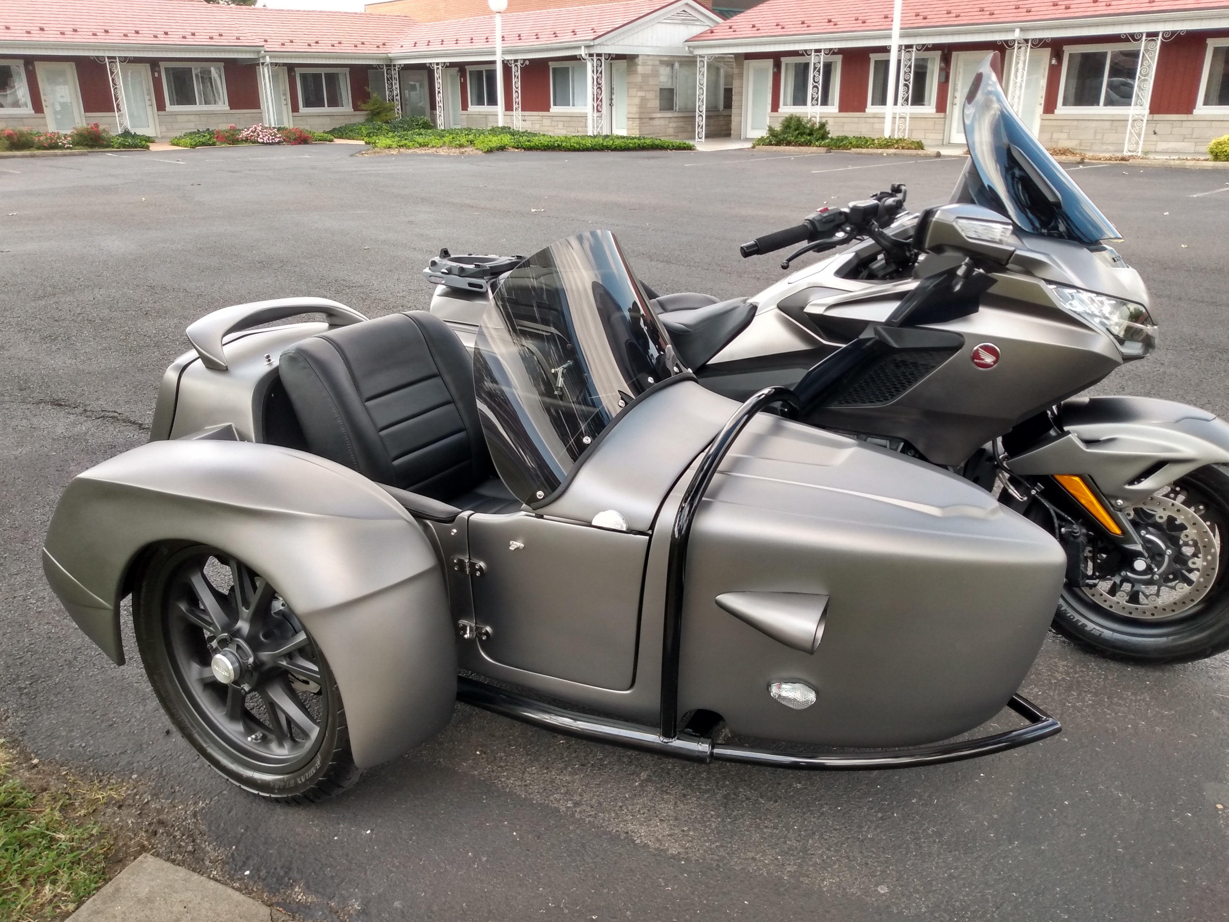

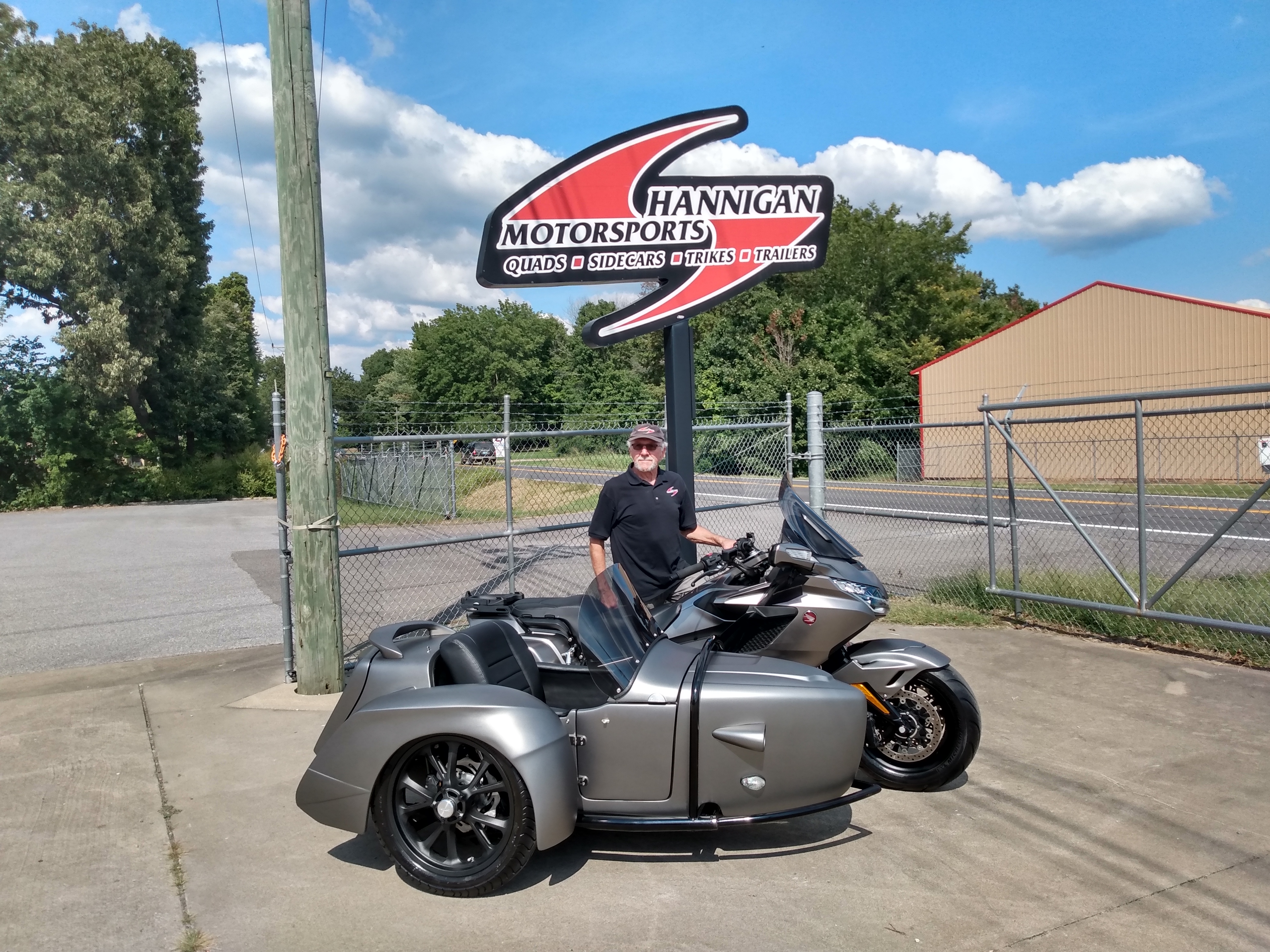

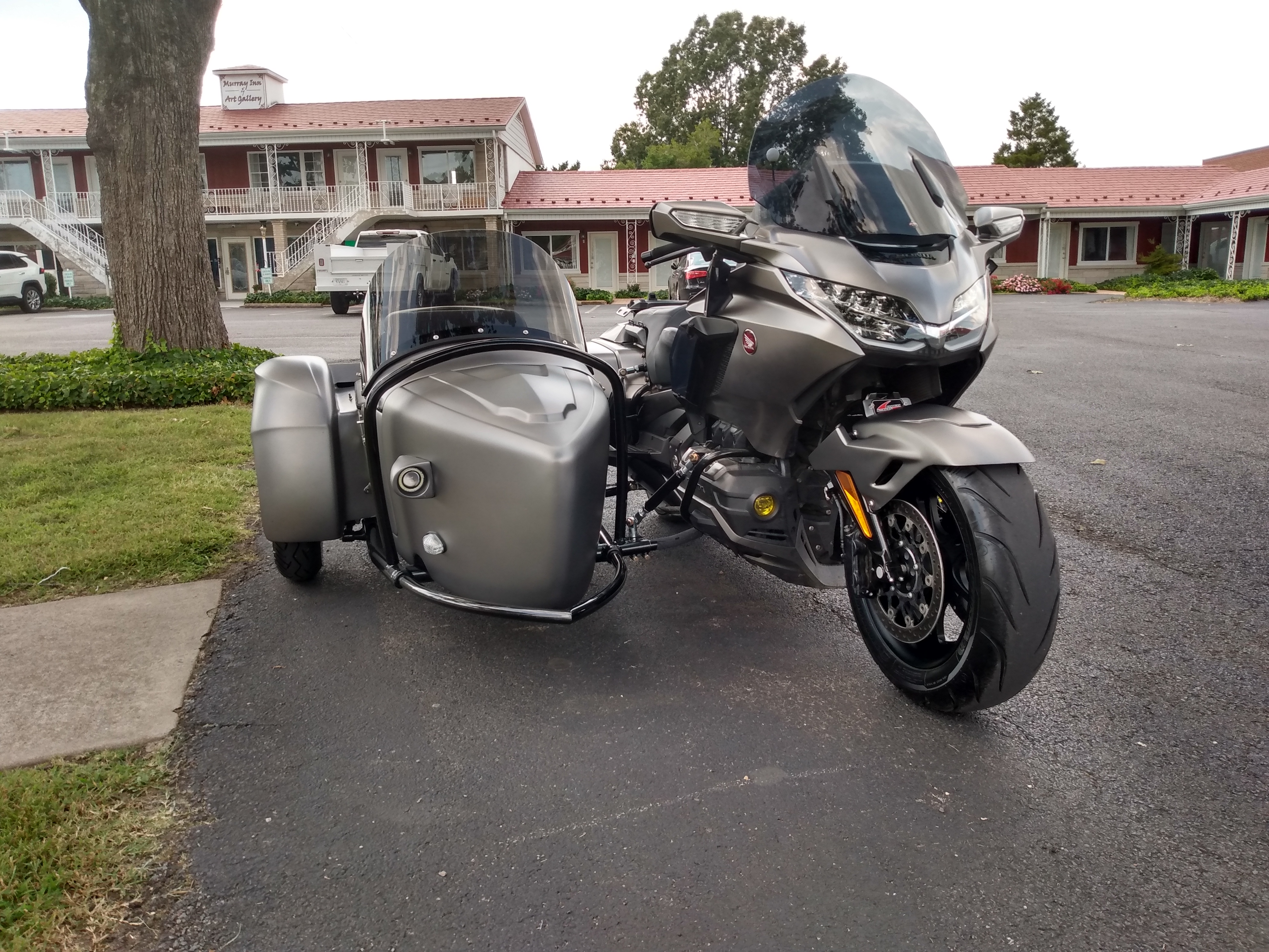

Rode my '19 Wing w/DCT out to Murray, Kentucky to have Hannigan sidecars install a new Gen 3 Dream sidecar, that I had ordered in May.
Spent 5 days there , whilst the gang at Hannigan did the complete installation.
Left there Saturday morning, driving the new rig back to Washington State.
590 miles yesterday.
678 miles today.
Will be 585 miles tomorrow.
And finally 535 miles on Tuesday...then I will be home.

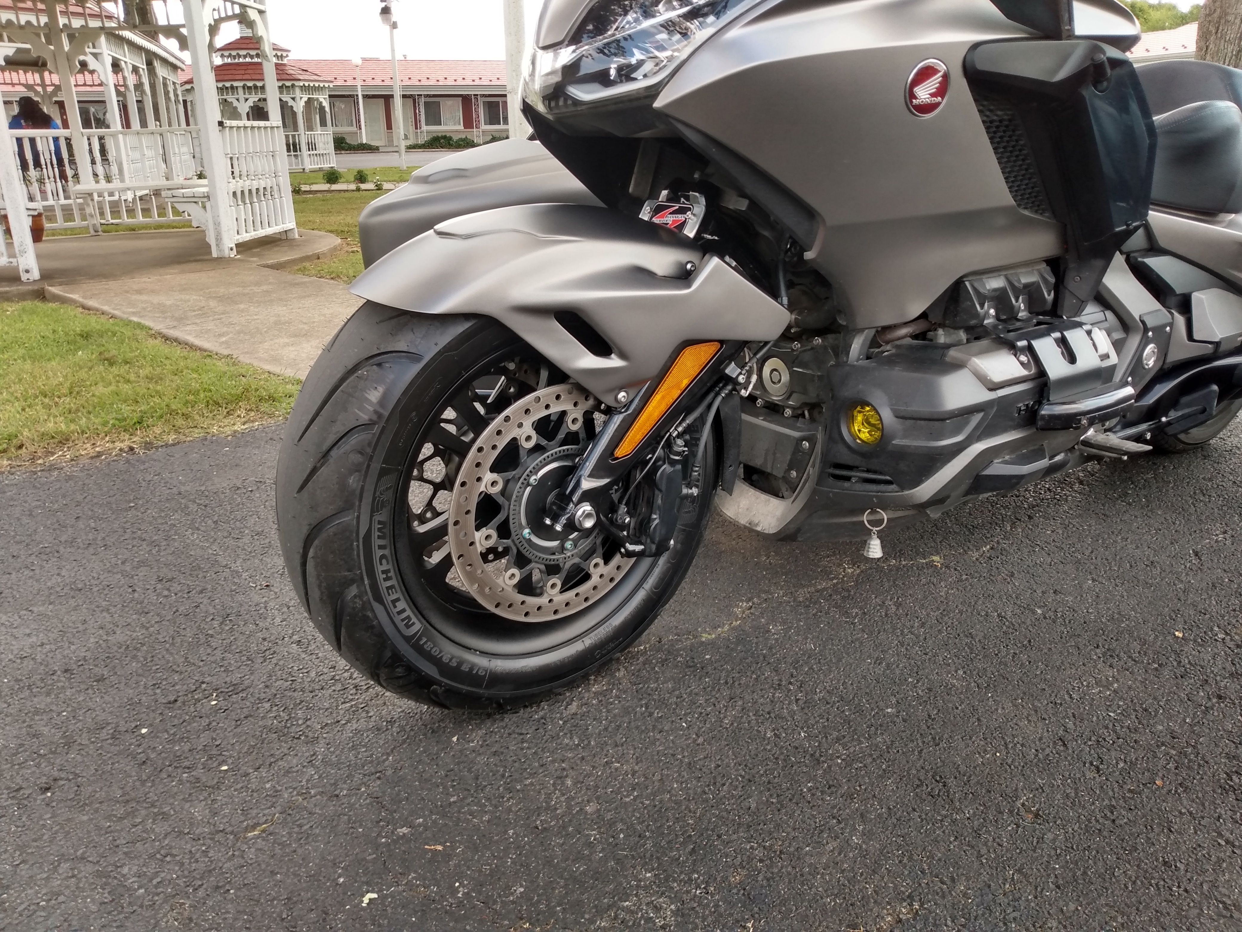

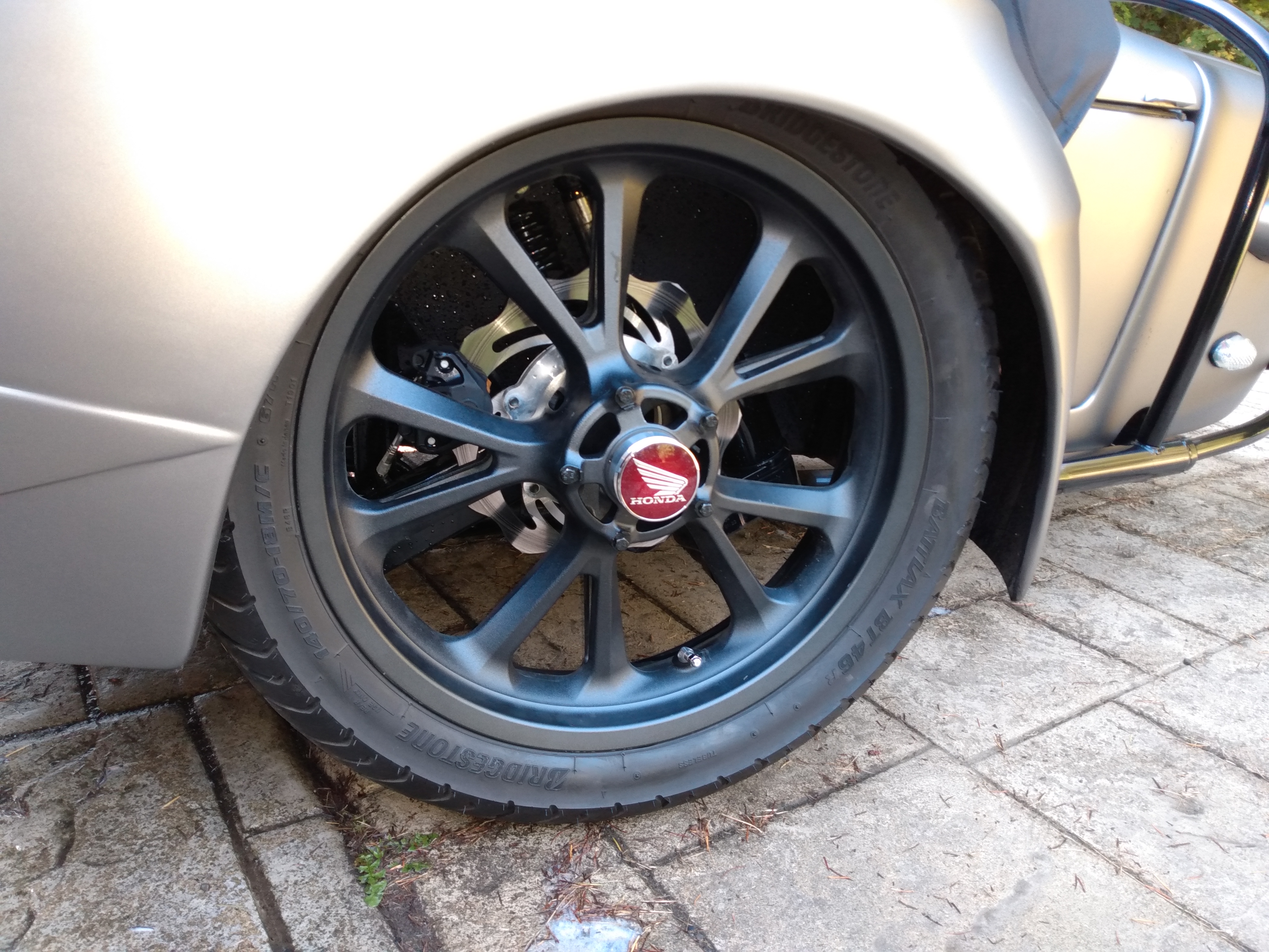

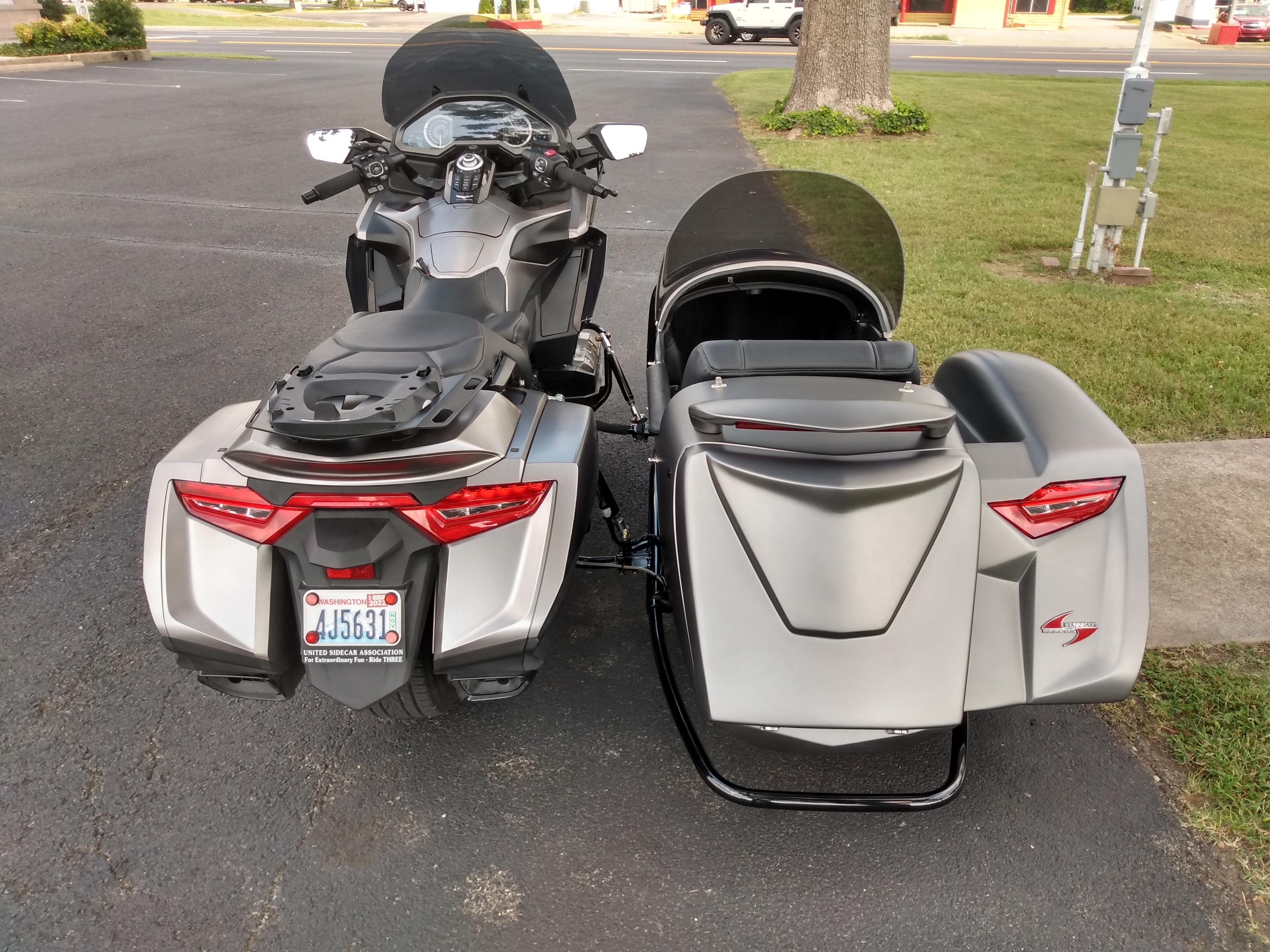

Yes, the entire front end is Super Wide. They moved my original front tire over to the sidecar, then installed a Super WIDE hassock front end, with new WIDE front fender, etc...and a 180/65-16 Michelin Commander lll tire. The new front end has had the trail reduced, so it steers much easier.
I had installed a new Bridgestone BT-46...140/70-18 tire onto my original front wheel, before leaving WESTERN Washington, to ride the bike to Hannigan in Kentucky. Once they started the installation process, they moved that original front wheel, and the 140/70-18 tire over to the sidecar. Also installed a new Yokohama Avid Envigor 195/55-16 run flat onto the rear wheel, before I rode out to Kentucky.

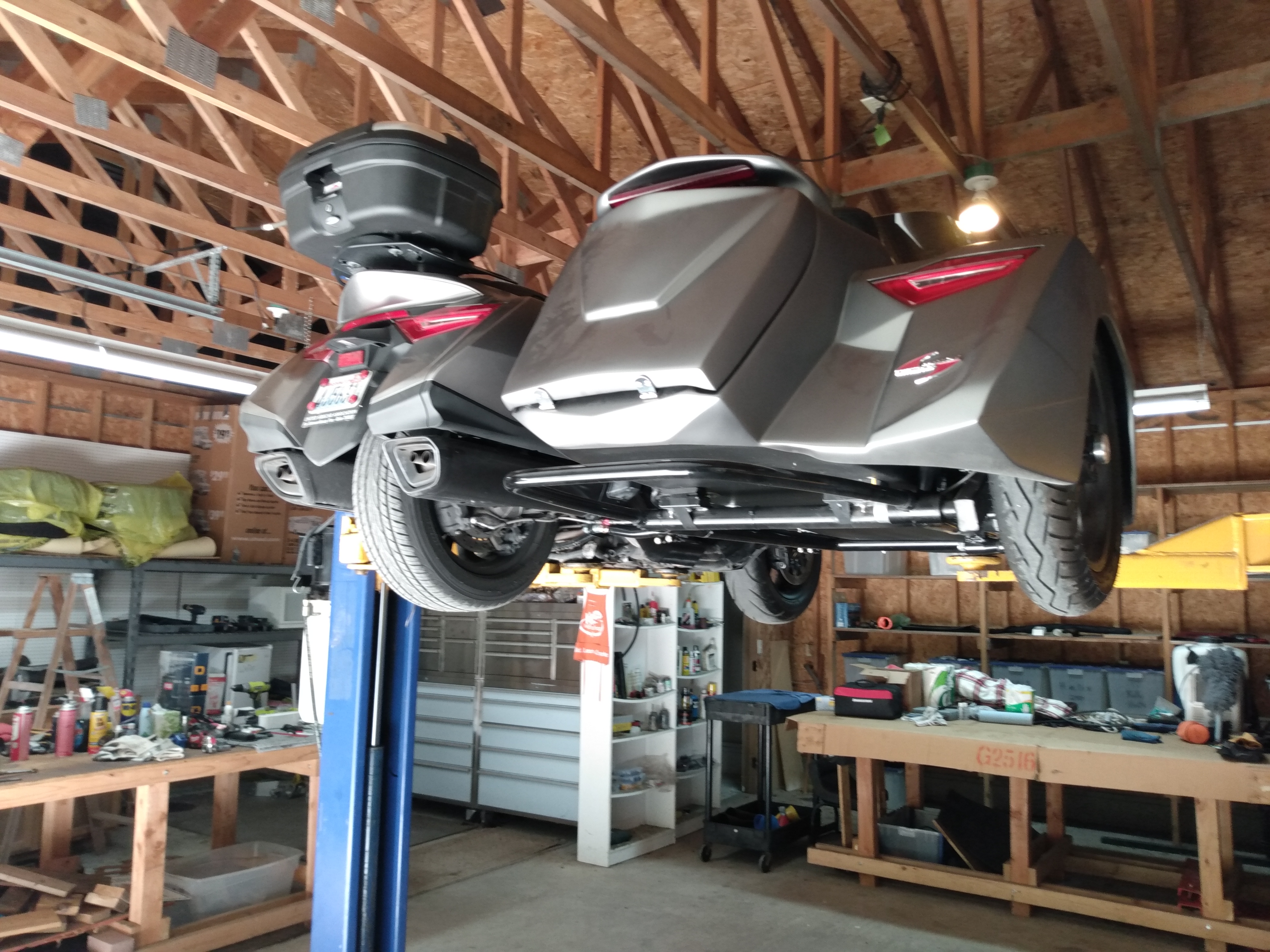

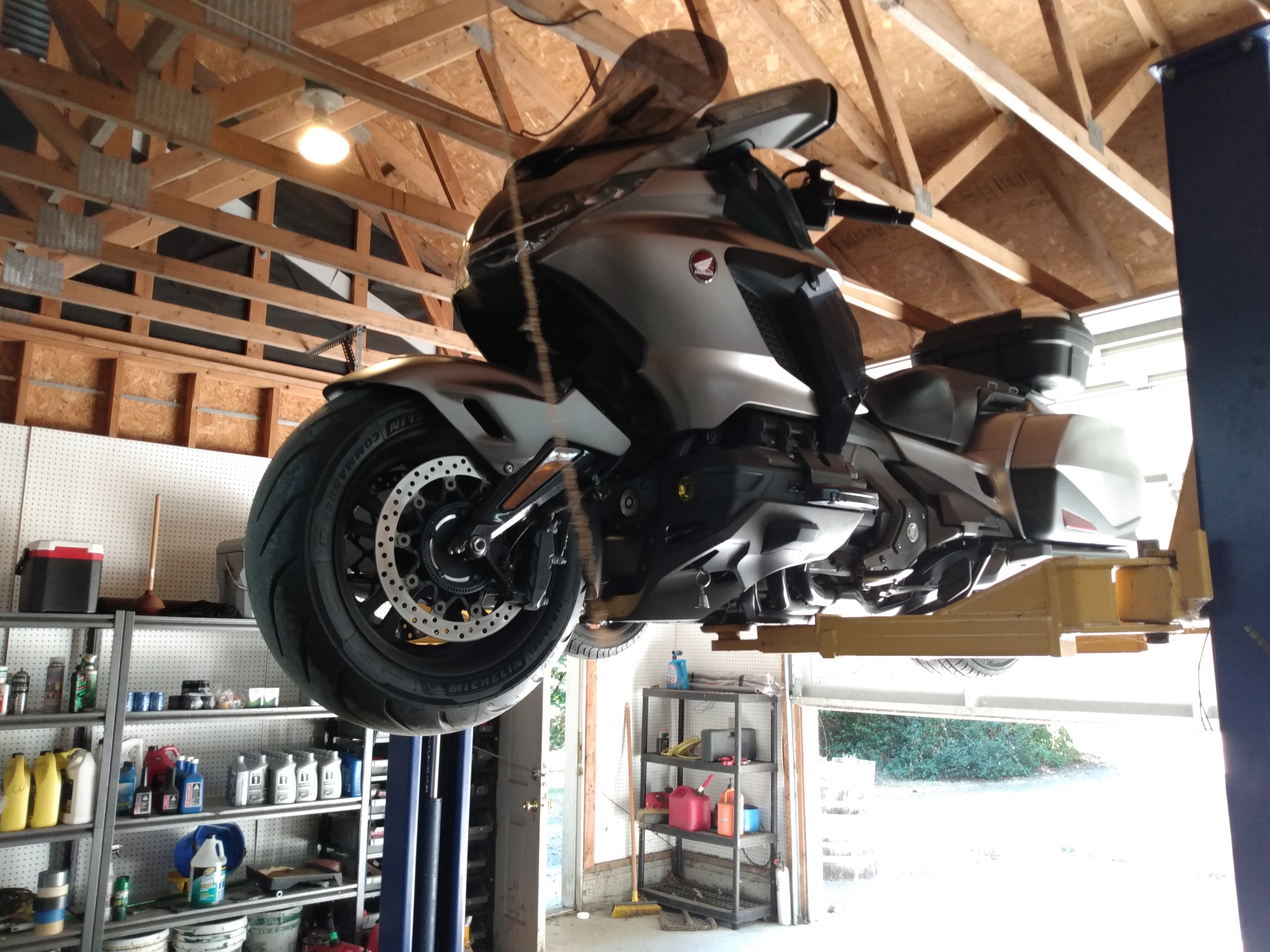

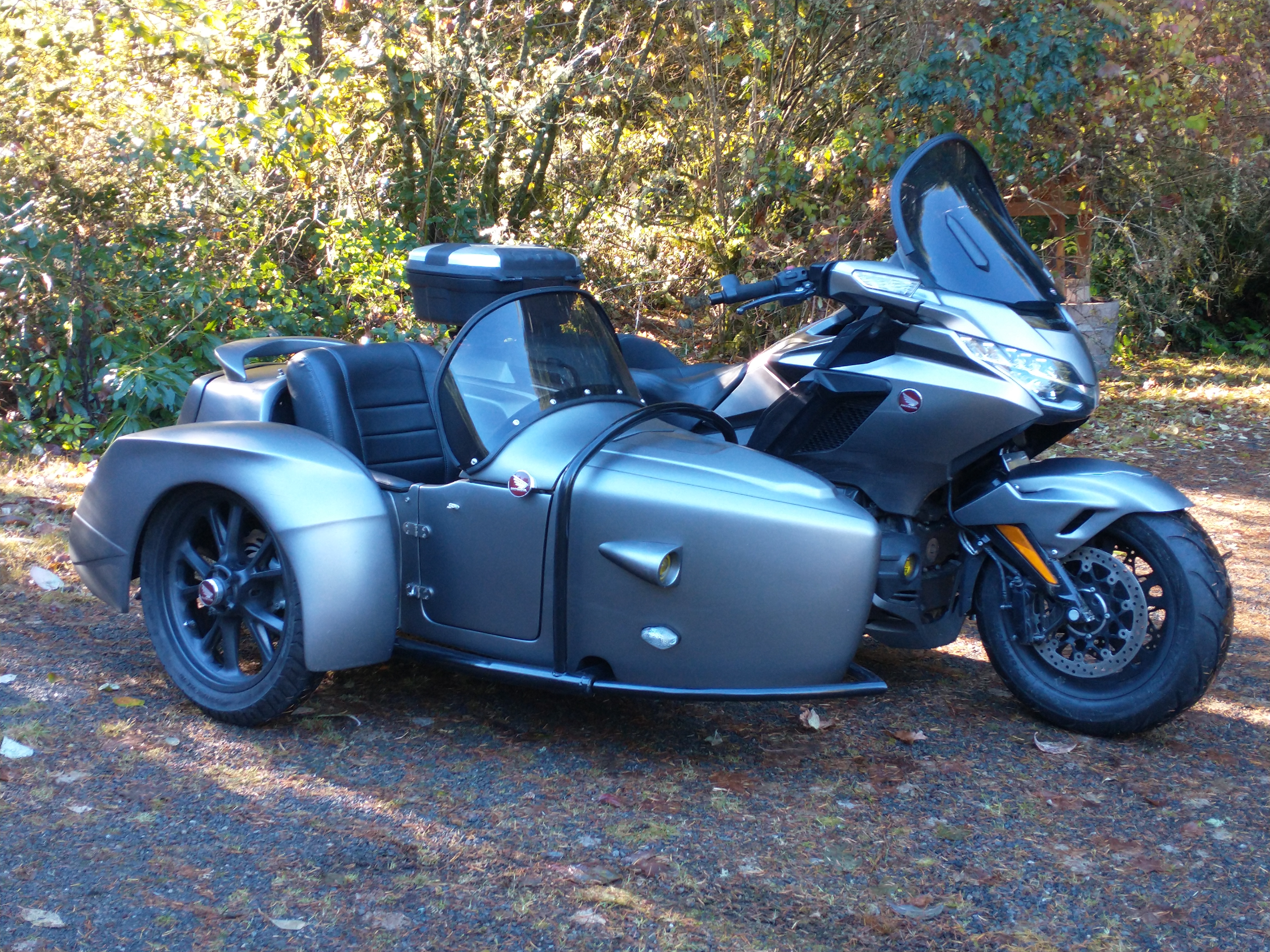

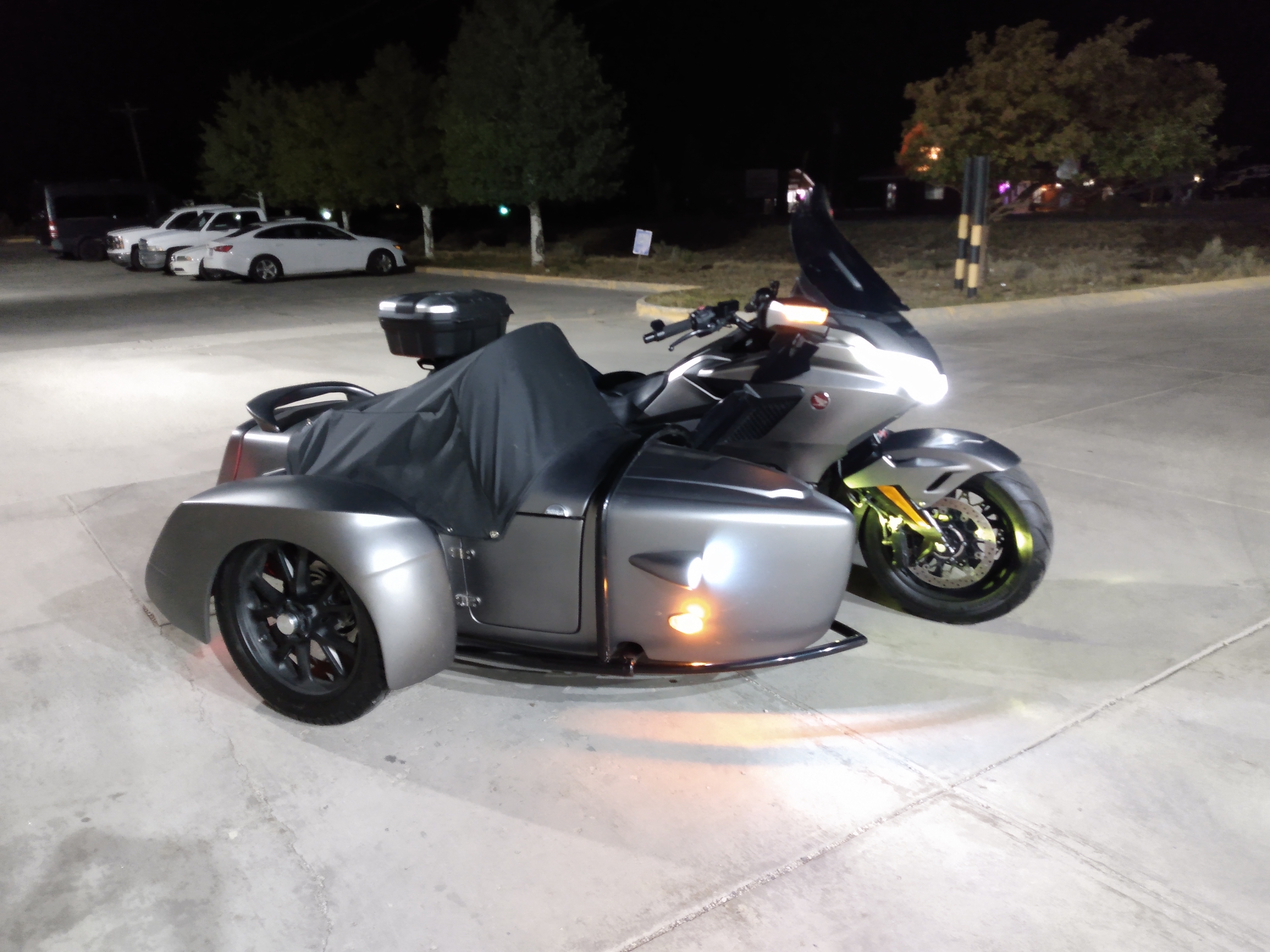

Just a few updated pics. And some showing my new rig UP on my car lift, in my shop. Much easier to work on a sidecar rig, if it is 6' up in the air.

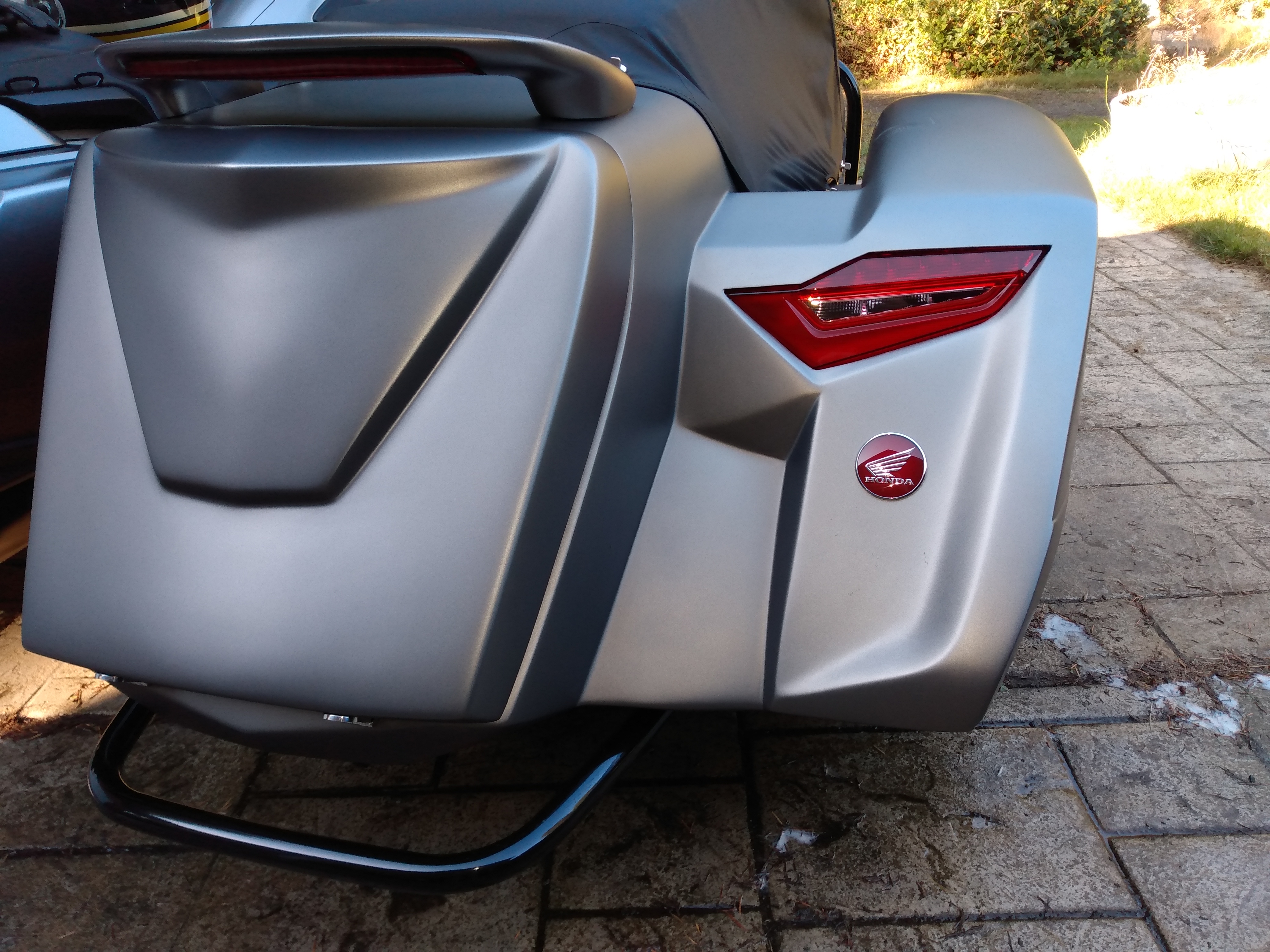

More pictures. Over the past 5 weeks since I have had this new rig home, and in my own shop, I have tweaked this and that, to make things the way I want them to be, regarding heat shrink tubing on the wiring, installing washers in places I thought there should have been washers in the first place, enclosing all wiring inside the plastic sleeve to protect the wiring...little things like that. I have to give Hannigan Sidecars kudos for doing such a good job in this build, especially compared to what other sidecar companies in the USA have produced lately, but with any custom built sidecar rig, there will be the "small things" that an owner will want to tidy up, tweak here and there. In my opinion, Hannigan Sidecars gets an A grade for this build...I just took it to an A+, for my own satisfaction.
Slowly changing things from a Hannigan labeled rig, to a Honda labeled rig, and am considering calling it a Hooligan Sidecar
So far I have about 4,000 miles on the newly completed rig, and it does perform as well as I hoped it would, suspected it would, and expected it to.
