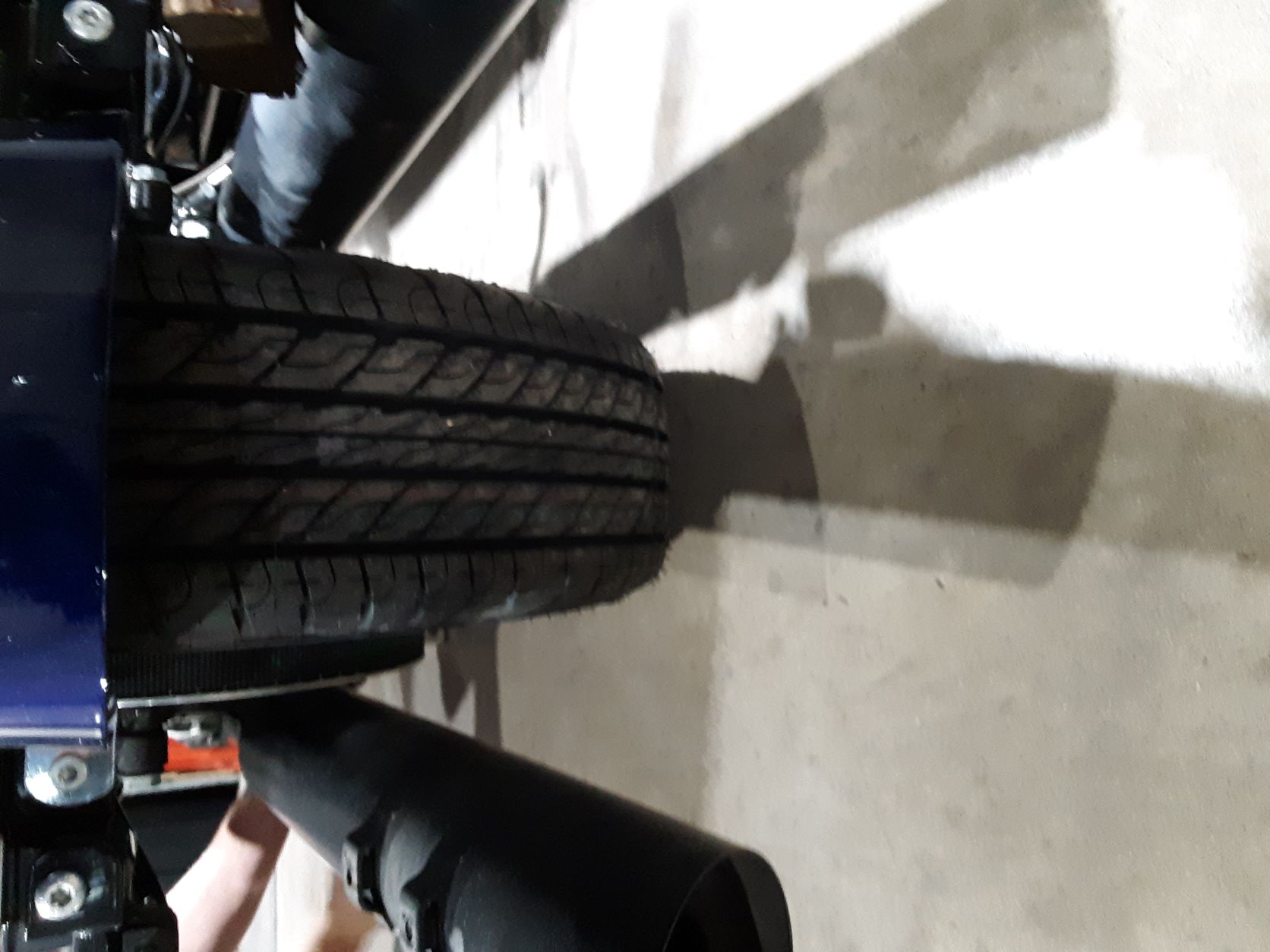

     Many Harley Touring bikes are coming with 18 inch  wheels  . Tire size in the rear is 180/55B18.  There is no car that will fit. Anything that would fit the wheel would not work on the bike. I ran into this with my 2020 Road Glide limited.
      I found the answer. Replaced rear wheel with a 16 inch. Found a TPMS that would work with the wheel and Registered it with the bike using a Centurion. Installed proper ABS and RDRS bearings in the 16 inch wheel.
      Mounted 195/65R16 car tire. This resulted in a replacement that is the same height as the factory Tire and wheel. Width is 1/2 inch wider and has no clearance issues.
  On a large rig like this the car tire works much better in the rear . finding the answer was a fun journey.
