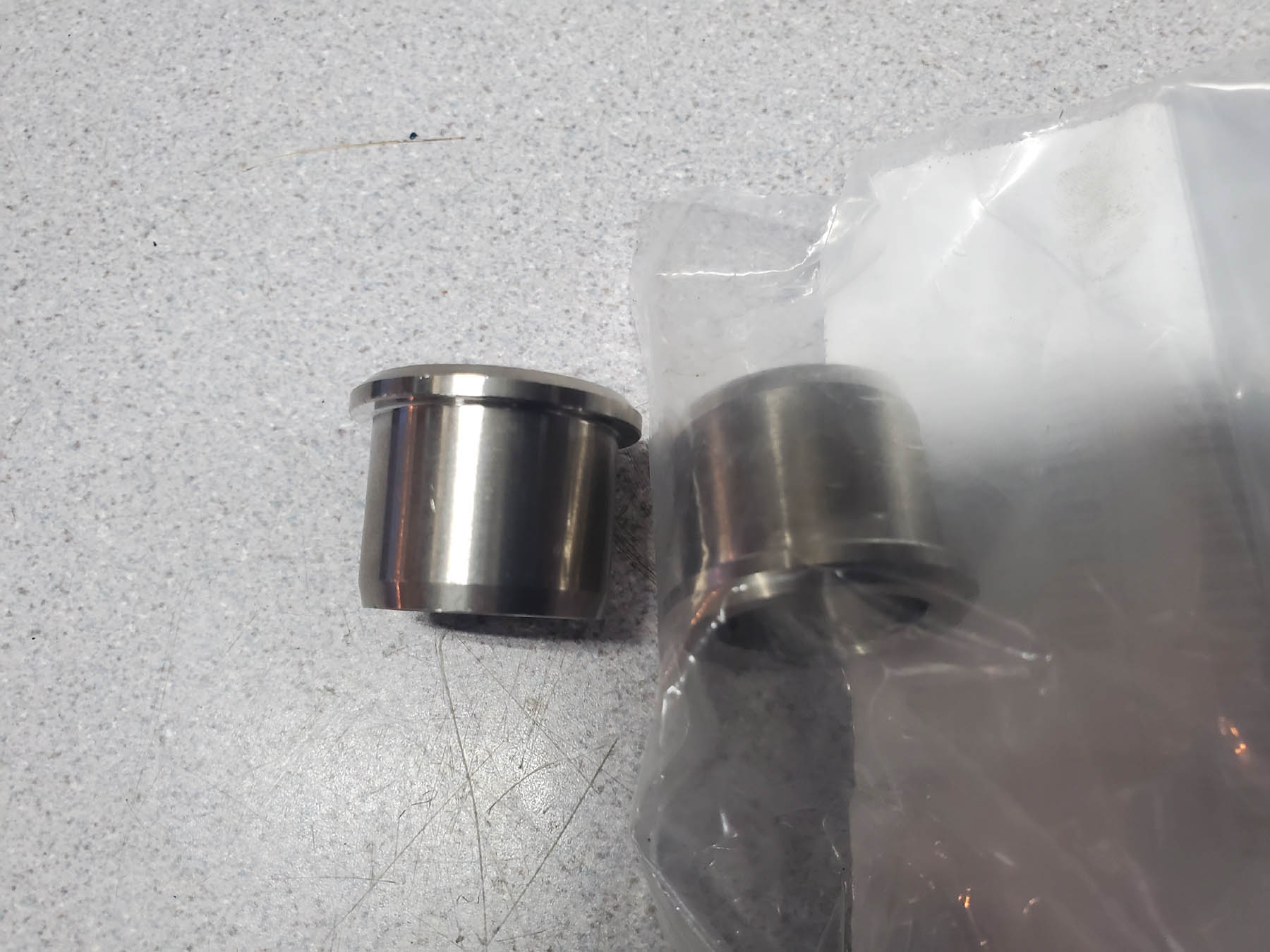

My 2011 R1200GSA came with a spare front wheel which I would like to use as a sidecar wheel instead of the Ural drum brake wheel that is on it currently.
The R1200GSA came with a 25mm front axle.  The Ural tub has a 20mm axle and I need to decide which is the best way to pair them.
Option A.  Use spacers.  BMW makes a spacer for the R1150GS/A which has a 20mm ID and a 25mm outer diameter.
Pros:
a. I have two of them but would have to get them turned down because they are only 20mm at the chamfered edge (see pic).
b. The inner spacer tube which runs through the hub from bearing to bearing is also 25mm.  Using the spacers would support it a bit, keeping it from moving or flopping around.
c. Others have used spacers so they could swap different wheels on a GS (ie. street, offroad)
Option B. Replace the bearings with ones the same width and depth but with a 20mm ID.
Pro:
a. The axle would rest right on the bearing instead of having a spacer between the axle and the bearing inner race.
b. Wouldn't have to take the spacers to a machine shop.
Looking for factors I might not have thought of.
Thanks,
Drew

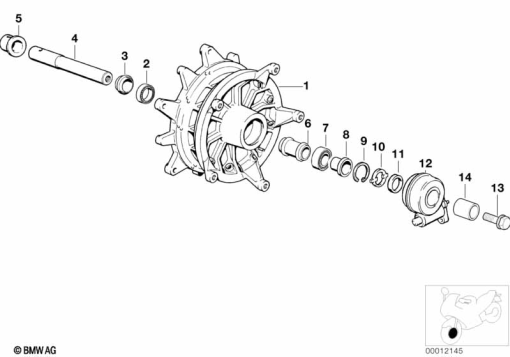

Sheath -
You actually have the same spacer (part #8) on the left side of your front wheel as the ones I bought to do this conversion because your axle is 20mm.
Yours has a lock ring after it (#9), then a driving dog, and the speedo.  (See pic)
Since I will be running a 25mm outer diameter spacer on each side of the wheel to center it on the Ural axle I won't need the lock ring to keep the inner spacer from moving outward and the lip on it will keep it from moving inward.
Posted : November 27, 2023 12:10 pm

The machine shop had another take all together.  They said there wasn't enough of a lip to grab the spacer so they would have to put it deeper into the chuck or the wouldn't be able to turn it evenly and I'd end up with an oblong shaped spacer.  Putting it deeper into the chuck would mean they couldn't turn it all the way down to the lip.
The result would be a spacer that went part way in then had a gap before the lip.
They could make me spacers but the cost of the materials alone (stainless) would be more than the cost of buying the bearings and going that route.
And that's before their labor costs.
I'm going to go with bearings for now.  If I decided I want the ability to swap the front wheel for the sidecar wheel, I can get spacers and bearings to match.
